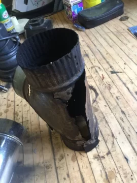

This is what corn exhaust does to a galvanized tee in one season. I use this as a termination cap. The Simpson shiny stainless term cap pin holes in abut 1.5 yrs. I just put a new galv. tee on each year, much cheaper. The pellet pro pipe interior still looks like new, but the alloy that the termination cap is made of does not hold up.

The pipe that you have shown in your photo is not pellet/multi-fuel pipe, there for the suger and heat off of the burning corn will corrode any less steel grade quicker, that is why the other pipe looks better. I have seen corn exhaust eat away pellet pipe over years of burning. TSC does sell Dura vent multi-fuel piping.
I originally had a Simpson stainless term cap on the pipe. But the alloy it is made of is the shiny style and corn exhaust destroys it in 1.5-2 yrs. At $40-50 each that gets expensive. The $10 tee once per year is more economical. It is a horizontal termination. If it was not for being on the west side of the house and needing some wind help I would run it open pipe.
The corn exhaust by itself isn't corrosive. It's when it mixes with moisture it then forms nitric acid. That's why the inside pipes show little to no wear, while the outside end pipe takes the brunt of moisture and rots out.
That's why it's important after the heating season to run a load of pellets on high through the stove, do a deep cleaning, coat interior with oil and stop any air flow through the stove during the warm humid months. Even adding damp rid is a good idea, or just use calcium chloride in a bucket to capture any moisture getting in the stove.
