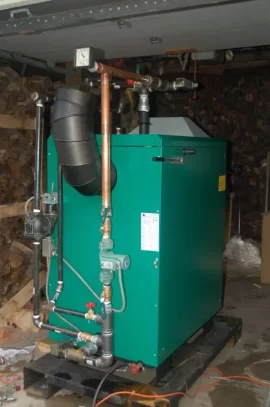

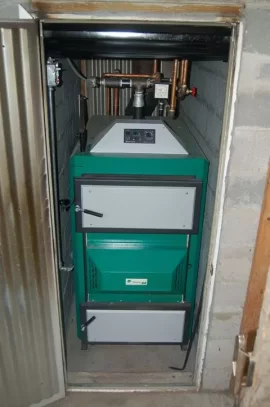

I did it myself, but it took a long time and wasn't cheap. I'm sure a pro could it fast and probably for less, especially if they know what they're doing. If you're not really into this sort of thing, don't try doing it yourself. Your installation cost is going to depend greatly on what you have already set up and how you want the new boiler to work. Impossible to ballpark, but I'd budget around $3,000 in addition to the cost of the boiler. Even if you're tapping into an existing heating system, there's still a lot of stuff you have to hang on the gasifier to protect it and make it work right. Fittings and parts ain't cheap.
With the exception of the boiler, nothing you see in these pictures is included. In my case, I'm pumping two hot water lines (1" and .75") 100 feet into the basement, which is a lot of additional pipe, fittings, pumps, insulation and other crap.
Things to consider:
Class A chimney?
Buffer tank?
Bottom line, I'm having a blast.
