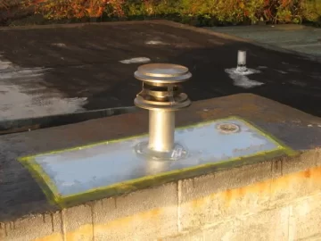

Can you provide us with a picture of the venting from the outside.
Then can you tell us the venting manufacturer and how it was installed.

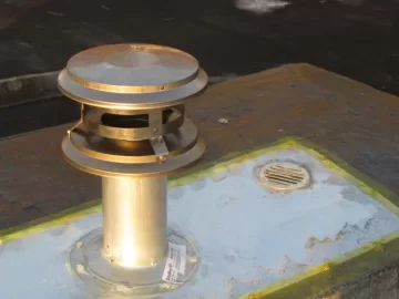

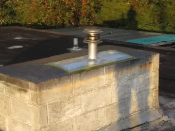

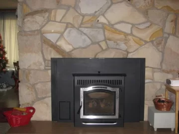

Smokey, here's a couple of picts.
Pulled the insert out and it looks pretty clean, no ash etc. The fireplace damper itself is open and the exhaust vent pipe goes up through it and terminates at the end of the chimney. It's a solid flex pipe. There is no fresh air pipe attached to the insert. Just the vent on top of the chimney. We didn't install an OAK, as both dealer and installer says its not needed as it will pull enough clean air from the vent. So I'm thinking I'm going to have them come back out and install an OAK just because I say so. Can't hurt is my thinking.

Well if that flue isn't sealed to a block off plate and that sealed to the chimney that lovely OAK unit on the top plate can be the source of your smoke smell. Something else about that top plate that OAK setup like it is can allow water in and believe me you do not want water running down the chimney, at least this rather old bear wouldn't.
