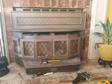

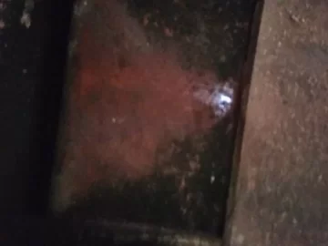

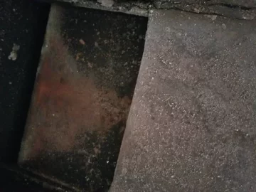

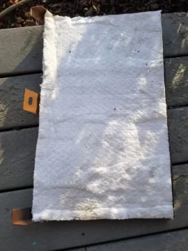

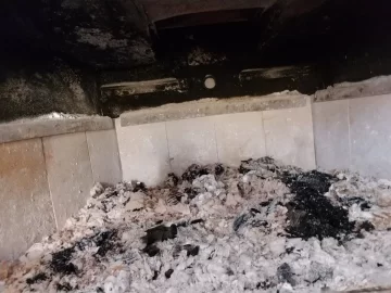

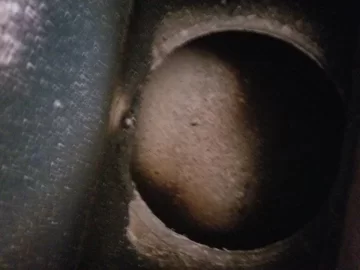

I need help with my Orrville Country Comfort stove. I am not sure which model it is, but I need help determining if I will need a catalytic.
I replaced gaskets, ceramic blanket, and replaced the bricks.
Can anyone assist?

The insert doesn't appear to be catalytic. But much more importantly - The grillework above the insert surround looks like it is for a zero clearance fireplace. Is this stove installed into a zero clearance fireplace or a full masonry fireplace. (A ZC fireplace will have a metal chimney). This stove must not be installed in a zero clearance (factory built) fireplace.

Is the insert hooked to a liner going to the top of the chimney? And like begreen asked is that a masonry firebox with a masonry chimney or a prefab fireplace with a metal chimney?
