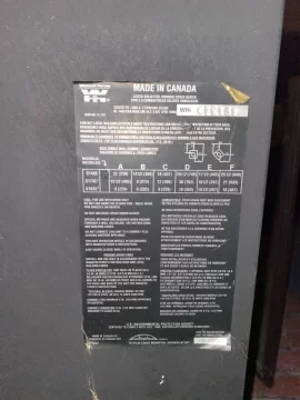

Also, there should be a data plate or sticker on the stove. Here is what it looks like, this is the one of my stove, but yours should look similar
  • [Hearth.com] Catalytic combustor for country comfort cc325
