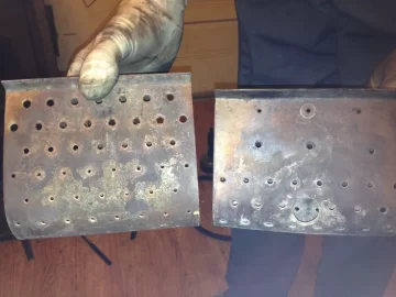

Okay, we've run a hose all the way through the U, it was not blocked. The AES tech support wanted pictures, said it was bad fuel or not getting air. Our other pellet stove is burning fine on the same fuel. He also said that we were using a corn pot instead of a pellet pot. So, here's a picture of both, which is pellet and which is corn?
  • [Hearth.com] Countryside Baby Magnum Feeding too fast
They both are the corn pots, not the Stainless Steel wood pellet pot - part # BC 2600

Don did you click the picture? There are two pots in the big picture. If you're only looking at the thumb nail, then we are burning the correct pot. The pot on the right (you can't see it in the thumbnail) is the one we're using. Sorry, I didn't see you said they both were corn pots. They have very different amount of holes in them.

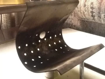

Which one is everyone modifying?
This is a picture of my burn pot. I welded all the rest of the holes shut. I also had holes on the side walls of the burn pot that I plugged with high temp muffler putty that I got from a local auto parts store.use a thin layer, trying to just fill the holes.if it is to thick the burn pot has a tough time coming out. The front edge and the back edge of the burn pot have to seat properly so all air flow is directed thru the holes in the burn pot. Have you blocked off some of the air wash? Hope this helps.....

Yes, we've blocked the air wash, I just don't understand why it would have an air problem now, when we haven't had a problem? It's a pain in the rear, it's going to be Zero again here tomorrow. :(

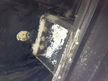

rafmt, I can't get it to burn long enough to get ash now. It USED to throw up sparks when it was burning. We ran a hose through the U area, and was able to move it back and forth. Now, if it lights and burns, it just blackens the pellets and burns out.
