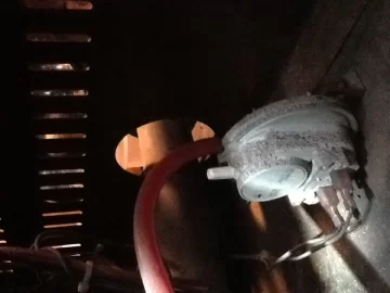

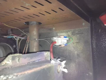

How do you clean the tubes in the top, other than with the rake? We have to be missing something. We also noticed that this is like not hooked to anything, not sure why it would matter as it was burning fine with it like that.

That's the vacuum switch that's supposed to shut things down if low vacuum making poor fire etc. Looks like this stove has had problems for some time.
This thread has been attempting that.
Could be the exhaust fan failing. Age of the stove not that it would matter as AES had Chinese make a bunch of them and heard they were scraping them for parts as they had high failure rate.
You don't fix low vacuum you fix the air flow.
It is the air flow that creates the proper vacuum and causes that switch to close and fuel to flow. Any damper needs to be in its track and close to properly adjusted.

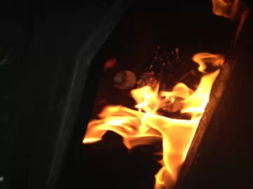

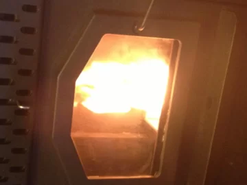

He took the airgun to it. The U was fairly clean from the other cleanings he did. BUT, the air intake had a bunch of crap come out of it, we had already gotten some out of it, but taking the air gun to it really blew it out. He put muffler tape on the top two rows, but will have to weld or use the putty, the tape isn't holding very well. The blower is actually kicking down a notch now instead of blowing at the same speed constantly. Sparks are flying again, the pellets aren't building up in the pot and I think it's actually burning better than it has since we bought it. Thank you all for your advice and help.

Good to hear your getting heat from it again. Did you get the vacuum switch operational?
Reactions: brown352
If there is two spades to hook to no problem as its not polarity specific. Make sure the hose is clear and drawing some vacuum.
