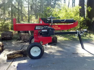

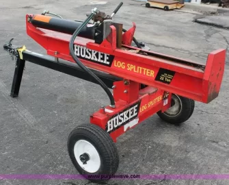

It is just my opinion that the newer design is more vulnerable to engine damage. With my older TSC design the engine is on the same side of the splitter as I am, as you stated; any log that wants to roll off the splitter would have to roll/fall through my body to get to the engine, and it's never happened. Before I added a log catcher, I would routinely have logs hit the tire and hydraulic tank on the side opposite from me, where the engine gas tank now resides on the newer designs. After I added a log catcher this didn't happen nearly as much, but it does still happen, especially when a hard splitting log suddenly explodes apart. If a large half round where to hit the gas tank, it could cause damage. It's no different than some of the old Troybilt Horse model rototillers, with the exposed carbs. They finally had to put a cage around it so people would stop snapping them off, usually when putting them back into the garage.

Please don't take my opinion as criticism of your new splitter, that was not my intent. Speeco makes good splitters, as do many others. Wood splitters are really a very simple machine. If it were my splitter, I would look for a log catcher, like you are doing, because splits will pop that way from time to time, like I said usually during a hard split where the one piece will pop off the splitter. If they don't come out with a catcher for yours, which would surprise me, I'd look at making one, or a guard for your engine. A cracked fuel tank and a hot muffler are a bad combo. See my post above to see my old design.
