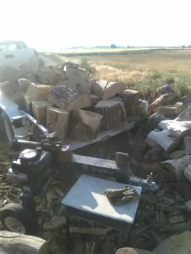

I have a 2'x4' upside down box next to my splitter where the wood requiring to get split is unloaded from my truck, when i have it full i start splitting till it's gone. Each piece i split goes to the wood shed while it's in my hand.
As
[Hearth.com] Accessories for older MTD 25 ton splitter
i am unloading the smalls go from the truck to wood shed
