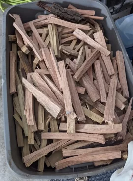

Heating the flue is simple, just start a top down fire. Look at youtube for examples. It gets the heat/smoke further up the stove pipe so the smoke doesnt come back down on you and inside the building when you start your fire.
That's some nice kindling!
Yes this stove takes alot to get going. For me, last weekend, it was about 8 hours. You have to burn the first three loads on the hot side to produce enough coals, otherwise you'll end up with a modest to low coal base and a full load just wont go that great unless you have overly seasoned wood. And by the first three loads I mean, that first kindling load - then the few small splits - then the next batch being about 1/2 full of smalls and maybe a medium. Once that last load looks like mostly charcoal and you can split logs up easily into bits with a poker..the stove is finally ready for a full load...or 1/2 or 3/4 - whatever, but it's ready to be loaded, let it catch for 20-30 mins then flip over to secondary.
