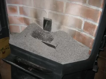

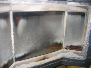

Here's a couple pics of mine: One is of the door, so you can see what mine looked like after about a week of burning. The other is the burnpot, again after about 1 week of 24/7 burning. I cleaned the stove, but could have gone longer....guilt got to me....LOL.

I'd like to see a pic of your dirty glass. The glass gasket usually only needs to be repalced if you are replacing the glass. Are you talking about the door gasket??

As far as the gasket is concerned I was probably a little hard on it the first few years before I found out it's not supposed to be sprayed with Windex. If you look at the picture above, my left and center panes would look just like that after a week. The glass pane on the right, near the hinges would have a thick black creosote type substance on it. I've done the dollar bill test a few times and it always passed. I've also adjusted the door hinges a few times since new and it never makes a difference. Another thing I noticed is that along the edge of the part that gets gunked up the paint on the outside of the door is flaking off.
As far as the ash tray is concerned, I'm not talking about the sliding ash door. I actually have a tray, or container in my stove. You lift it out of the firebox and can dump the ashes out of it. It's over the ash pan doors and surrounds the fire pot.
