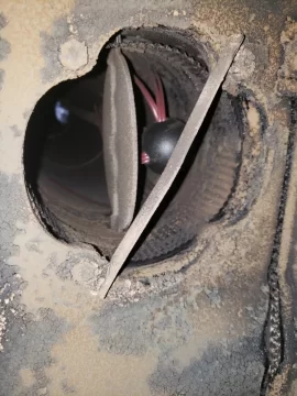

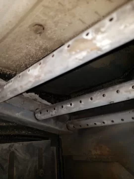

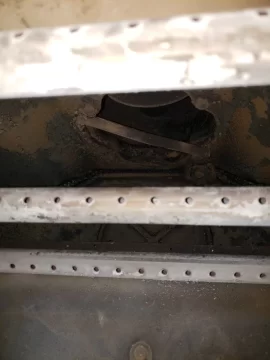

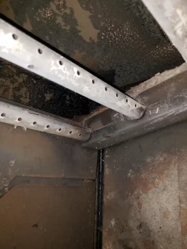

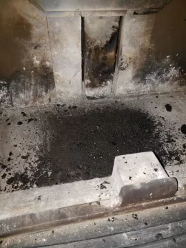

Im waiting for the tools to sweep the chimney myself in the mail. I was going to have it professionally done but its hard for me to be home during the week when they are available. Since i know ill be doing it this week coming up and my stove is cold right now I decided to remove the baffle to see what that entailed. It was easy enough but im a little concerned with what i found.... the stove pipe past the flue damper looks fine as youd expect right above the stove. Before the damper and in the back of the actual stove before the flue i found a lot of flakey creosote that chipped right off, but it has some glazed creosote underneath it. From my last couple of posts here i know that i was doing a really bad job burning when i first got my stove and im attributing this to the poor job i was doing. However, is this common? Is this a hazard? Ive been doing a really good job of burning lately how has this not burned off? And what kind of brush can i use to remove the glazed stuff

Maybe snap a few pics and post them so we have a better idea of what you need.
I have the stove running again so ill grab some pics tomorrow. It might make my post make some more sense

So I swept the chimney from the top down and thats what I ended up with not including the cap which was the worst part. The buildup i was talking about in the original post is what you see in these pictures. Is that normal?
That looks pretty good,maybe a cup or so?
Yeah its far less than i thought id get but a lot of what i thought was creosote was just ash. Any ideas on that buildup inside the stove though? It is hard to get off and looks like creosote to me
I don't see anything alarming. What stove is this? Can you add it to your signature line in your account settings?
Sorry i think that youve asked me to do that about 5 times now. Its a hearthstone manchester. Im not so concerned with it in terms of a house fire..... i was just under the impression the creosote should be at or near the chimney cap and not before the flue. Im guessing its from a lot of cold starts?
That's a reasonable guess. Thanks for the add of the stove.
Looks pretty minimal to me especially if you were burning questionable wood.
