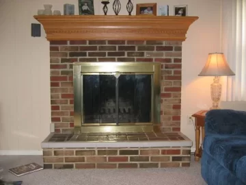

Also, I've attached a picture of my fireplace. It's just an average looking fireplace with a raised hearth about 12" high.
Would a stove look weird in this setup?

The right free standing stove would look great in that fireplace. But you are going to have clearance issues with either an insert or a stove with that mantel.

A stove might be a bit tough gettin clearances to combustibles but an insert shouldnt be a problem and would look just fine. Better in my opinion

i dunno, some inserts woud cause clearance issues ,maybe not all, depends on how much hearth is in front of the fireplace opening also, didnt the guy who MSG helped ou (mike) have a "flush mount" insert? ,first step will be getting good measurements so that you will be able to shop for one that will fit your footprint. looking at the picture of the fireplace its hard to get a feel for the scale. i agree with craig that an insert or freestanding unit would be a better investment. maybe post your measurements and we can crunch some numbers to see what can fit that footprint
I think a flush mount insert would look better in that space than a stove, and probably cause fewer issues other ways. As stated elsewhere, each insert has it's own clearance requirements, but so do stoves.
I think just about any sort of stove would require you to significantly enlarge that hearth in order to get clearances on the floor, an insert that was close to flush with the firebox probably would work with the existing hearth, or require only a minimal depth increase.
The other big issue, as mentioned is the mantel - again, it depends on the insert, but you might be able to get away with the existing setup (it looks like you have about 12" from the mantel to the current top edge of the stove going by the brick count) or you might be able to install a metal heat shield under the mantel that would solve the problem.

We would need (at least) the following numbers - Height, Width and Depth of the firebox (without the doors). If the firebox goes straight back, or if it is tapered in on the sides. Width and depth of the hearth. Distance from the bottom edge of the mantel to the top of the fire box. Distance the mantel sticks out over the firebox, and how far that point is to the top of the firebox (Mantel clearances are a function of both how far they stick out and how deep they are)
