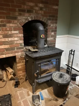

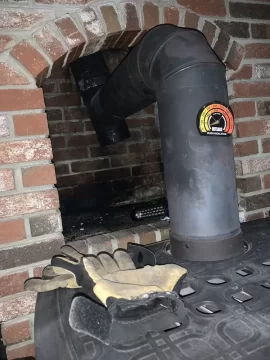

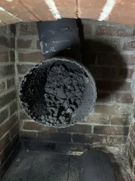

Following this post. I have a similar setup where it is a partial liner and vents to the old 8” clay chimney. Been doing this for 4 years. I’m having an issue where it is creating a lot of creosote build up at the tee. Wood is dry 2 years. Input is appreciated!

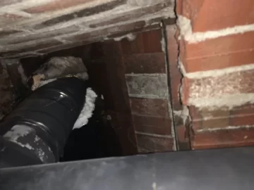

Forgot to attach picture of creosote after a little over 2 months of burning.

Doesn't that need a liner anyway? How do you have it vented now, into the old clay chimney?
Clay in good condition and built properly to start with and with the stove installed properly is perfectly acceptable to vent a woodstove into.

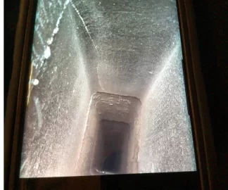

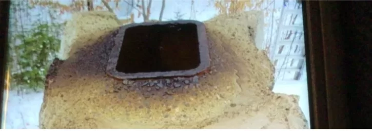

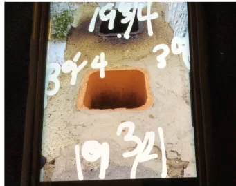

Here are some pics that the chimney sweep took. It looks like just one tile is cracked. Also, the quote said "Pre-Insulated 316 Ti-Alloy 6" should that help. What does SOP mean???

I am confused by the picture of a chimney with 2 8x8 liners then a pic of an 8x12 that doesn't look like it is used for wood with a crack in it
Never mind I looked at is again the top shot is an 8x12 with the wood staining. Still not sure why the pic with the crack doesn't show any wood staining.
But yes houses do burn down all the time due to chimney issues. Sometimes cracks but it is usually lack of proper clearance from the chimney.
The chimney is for both an oil furnace and the wood stove. I don't know anything about the wood staining but that is the inside shot of the wood burning part of my chimney.
So, is the 8x12 (now that I know what it is, so thanks) big enough to get the pre-insulated 6" pipe down it without having to break out the old tiles?
Not a 6" insulated round no. But an insulated y" equivalent oval should work.
