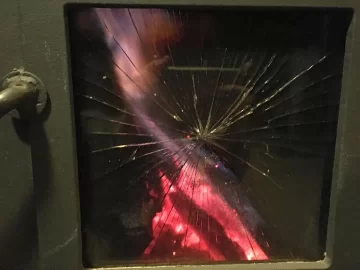

Last night while loading the stove for the night, the piece of wood that looked like it fit well enough wound up being about 1/8" too long at exactly the wrong spot. (See image below.)

Acknowledgment of likely stupid question in advance: is it dangerous to use the stove until the replacement glass drives? I can feel slight displacement of a few of the pieces, but none of the glass seems to be loose. Replacement should arrive mid-week & I have space heaters, but we live in a fairly remote area that got slammed with snow last night and today. And we have a forecast low of 12 degrees tomorrow night.
This is sort of a hail mary question, as I've already planned to go purchase an additional infrared heater tomorrow. Just figured it couldn't hurt to ask. ¯\_(ツ)_/¯

Bummer, bad timing with the nasty weather. Yes, it could be dangerous. If a section falls out while the furnace is not being directly watched too much air will be fed and an overfire could occur. If you have a stiff piece of sheet metal that could be cut and fit in there temporarily that would be better.

Thank you, begreen. That was pretty much my thinking on it. We're effectively snowed in & I can keep a steady eye on it (even a camera when I'm not in the room), so I've run it at a low temperature (~200F) this evening just to supplement what the space heaters are putting out, but there's no way I'd leave it burning unattended or while sleeping.
The other stabbing irony is that I work for a scoreboard company & we build all of our products from steel, so I could have gotten them to cut me a piece that would have fit in there. But the plant is closed due to the weather.
I did order the replacement from Englander today, but they're in the midst of a blizzard, so hopefully I'll get it by Wednesday or Thursday of next week.
