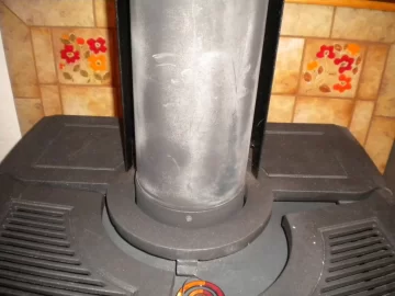

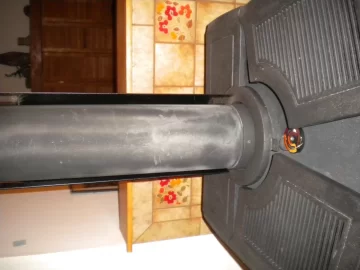

one more question--maybe should be new post---my stovepipe is beginning to lose some of its black--ghostly white blotches, mostly nearer to the stove but also trailing up the the second section. Is this sign of a poor quality pipe? It is new as of about a year ago.
Single wall? Dbl wall? Cheap pipe? Got a little hot? Pics?
single wall not sure quality of pipe--that is what I was hoping to find out--has happened slowly over time. [Hearth.com] crackling noises[Hearth.com] crackling noises[Hearth.com] crackling noises[Hearth.com] crackling noises

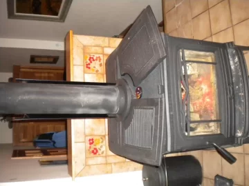

That shield behind the flue is interesting ..can you tell me about it?
THe stove was short on clearance from back of the pipe to the half wall behind it, just from the top of the stove to the top of the half wall. That is a distance of about 1 foot. The stove itself has a heat shield on the back. So the extra shield makes it like a double wall for that short distance to meet clearance requirement.
I have a very tight space and had to get a stove with the least clearance requirements for floor and half wall.
