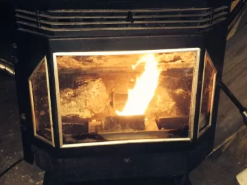

I found one for $600 that was working so you did better than me! This one had no fire brick backing so I got some to install.
These stoves are tougher on auger motors because they use direct drive for the augers(No Auger Bearings) so you may want to yank the auger and buff it out with a wire wheel on your drill and spray it down with dry moly. Also a high quality Gleason Avery 2 RPM auger motor would be a good upgrade. I also changed out the ash trap cleanout cover screws in the fire box to nice stainless steel screws for easy cleaning so the heads do not snap off! I like the hex heads so I can speed up the screwing with a drill driver!
Here is my pic, let's see yours?

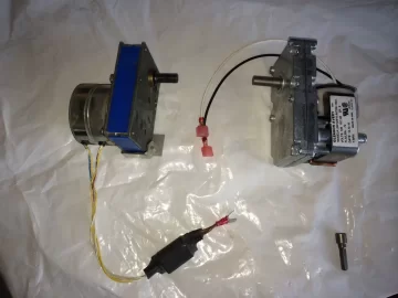

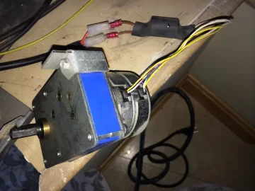

Does your Astroflamm have that blue gear box 1 RPM Auger Motor? If so do you like it or did you replace it with a regular one?

Don, do you have the part number to the Gleason Avery auger motor? I would really like to order one then keep the stock one for a spare.
