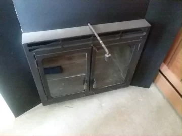

New here but figured someone here might be able to help me. I'm looking at an insert on CraigsList but don't know any info about it. Person selling it says it doesn't have brand or anything printed on the unit itself so he wasn't too sure. Does anyone know what kind this is based off the attached pic? I asked for more pics and will post them when they come through.

The picture makes it look like the front isn't even airtight- I don't know what that is but I would question whether it's even a stove insert.
If it's an insert, it has a dataplate on it somewhere that lists manufacturer and model.
In any case, I wouldn't take it for anything but scrap metal, based on how the doors are set up.
I have to agree. It looks homemade. The doors remind me of a smoker. Not that all homemade stuff is bad, but since it hasn't been tested, insurance companies might frown on it.
