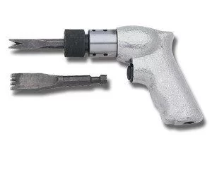

as we are already there on what tools to use, I just use a pneumatic chisel from
my upholstery workroom. We use it for taking off old nails and staples from furniture frames.
But is very well suited for taking off any creosote buildup in the burn-pot.
  • [Hearth.com] Creosote buildup in the burnpot
