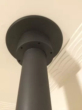

Hi All,
I had a Pacific Energy Neo 1.6 wood burner installed last winter, which has a triple skin flue from ceiling to exterior. This was installed by a local builder (whom certified the installation, required in Aus, NSW). I’ve had the bloke around to correct the flue once already as it was extremely crooked and looked terrible from the exterior of the house, but ever since it was corrected I am getting creosote falling through the vent holes in the ceiling plate which I have to clean up each day. I initially thought this was a result of a small amount of creosote entering the second layer due to what ever the bloke did to straighten up the flue, however it has been 7 months since the fix (and 4 months since fireplace was last used) and this creosote is still entering the house each day (pictured)
The installer seems to be ignoring my last request to come have a look at the issue, I’ve given up and would rather instead hire someone else to fix it properly or do it myself.
Before I start, is there a common cause for something like this or best place to start?
I.e is there likely a gap in the first flue layer which may be allowing smoke to enter the second, or more likely some sort of gap at the very top near the flue cap.

The flue system should be continuous from stove to chimney cap. There should be no chance of creosote occurring outside the inner lining nor at that location. Something is definitely amuck. This should be inspected and corrected by a good certified sweep and not the builder.
Yup. Something isn't connected properly. It should be gone right through before use. I would be looking first at the ceiling support box to make sure the stovepipe adapter is in place and connected properly to the first piece of chimney.

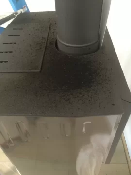

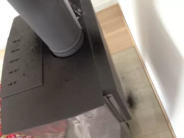

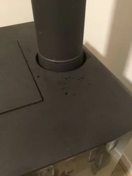

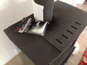

So far no success in finding a trade to repair this flue. Had a chimney sweep over recently to at least clean it out for me and give a recommendation (wasn’t interested in doing the reinstall). Apparently the active pipe does not line up with the cowl and pipe is possibly a few centimetres short allowing some soot/creosote to fall back into the other layers of flue. The inner and outer sections of flue are hard up against each other and can’t be realigned with the cowl/cap. As he brushed the flue, quite a lot of soot seemed to fall back inside the house.

Now the ceiling plate seems to be chockablock, the slightest vibration causes a shower.
