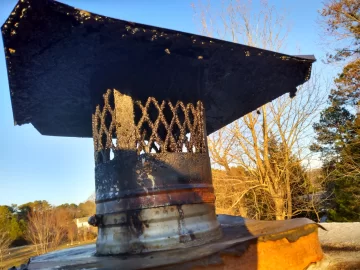

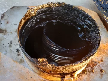

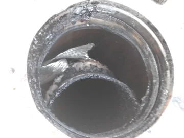

A few weeks ago, the insert started smoking heavily during initial lighting. Once the fire really got going, it would stop. However, since the issue persisted, I swept the liner, which helped slightly. Yesterday, I went up to the roof and removed the cap to investigate, and I found that the liner is not properly attached to the chimney cap. I’m not sure when this failed, but I suspect it happened recently, around the time the back-smoking started.

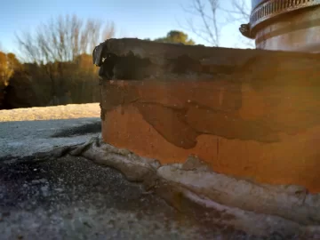

I've attached some pictures for reference. The pictures also show the cap before removing with a lot of build-up, but after sweeping the liner again right after discovering this, very little creosote came out. So, I suspect the cap is that dirty due to the failed liner falling out. Are those gaps in the caulk between the plate and the chimney tile normal? I apologize if I am using the incorrect terms or names of the parts. I know some of the users here are a lot more experienced in this and some are actual professional sweepers and installers.

It should be able to be fixed at that age
Yep, looks like liner slid down out of top plate. If it was partially block from exhaust coming up, that would lead to issue mentioned. Hopefully when liner was pulled back up into top plate, some screws were put through it to hold it in future. Good luck.

Screws won't hold in light wall liner
What do you use? I put screws through the top plate flange and went through liner wall, then siliconed all to seal outer areas...
There should be a band attached to the top plate that tightens around the liner, holding it up
I've seen that and have used that too, but screws seem like a good idea too, that's all.
