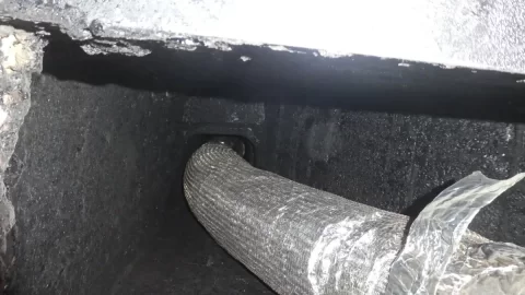

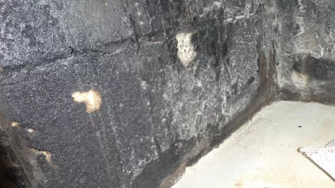

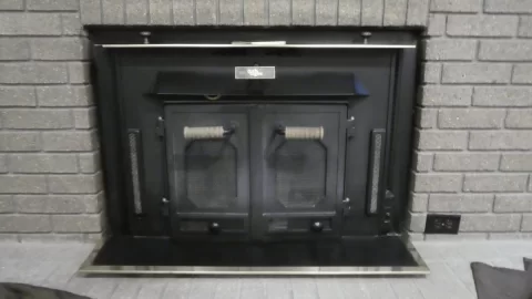

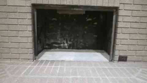

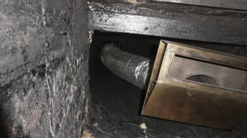

Can you show some pics? I am still not understanding exactly what is going on here.
Here are some pics. One is with the Buck Stove Insert in place. Two shots looking up the flue and 2 more with closeups of the walls. You can see where the walls have been chipped when they removed the creosote before installing the SS liner. The SS liner is a Heat-Fab Inc. Saf-T-Liner with Saf-T-Wrap insulation installed. At this time we are planning to install the two 3" vent pipes for the gas insert inside the existing 7" SS liner. The SS liner has been recently cleaned, there was only soot according to the sweep. We hadn't burned for many years but wanted it clean for the install of the gas insert. Not necessarily for the installers convenience but to try and make it safe and keep as much mess out of our house as possible during the install. BTW - This is the guy that scared us by stating he wouldn't use this for ANY type of installation but after he was done cleaning he did state it should be OK for a gas insert.
Everyone we have talked to at the various gas insert stores we have visited while shopping for the new insert has stated that the new gas insert will not burn as hot as a wood fire in the old Buck Stove would have burned so there shouldn't be a problem. We don't have any CSIA Certified sweeps in Utah so having someone local with the right knowledge isn't possible. The City's building inspector also stated there wouldn't be a problem. He even stated if the new inserts vents were double walled the SS liner could be removed entirely.
With all the different opinions, we are just very confused.

Yeah I would not have installed an insert in it like that. I would have chemically cleaned it. They are right the gas will burn cooler but that doesn't change code. By code that needs to be cleaned much better.
