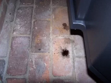

Hi, Finished my last break in burn three days ago. Have used stove three times since then. This morning I noticed some black sooty water leaking out the back bottom of stove around the outside air kit. Pic attached. Advice needed ASAP.
PS - I am burning dried hardwood.

There is a seal problem with that stove not because cresote is dripping but it is being formed there because a gasket or seam is allowing cool air in a condensating and creating cresote when you warm up the stove it drips out indication a poorly seared area.
Another consideration is if you have a full liner then there is a chance water is getting buy the chimney cap collecting cresote and running down the chimney and depositing it to leak out your flue outlet chamber you might want to check the cap and the seal around it keep out as much cold air up there as possible from condensation by cooling your liner. also seal the bottom damper plate.
Is your chimney an exterior location is the liner insulated?

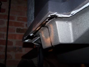

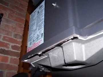

I just looked again. The creosote formed during the initial startup of the fire. Now there is none. Here's another pic. Looks like the metal is damaged. Hard to see in this pic, but I can def see w/my flashlight.

Should the hole (which appears to be for the outside air kit) right near where creosote is leaking be blocked off? You can see it clearly in pic #2. I am not using an outside air kit. I did not install stove.
Hold your horses here IF there is refactory cement bricks or interior liners there, and you stove was a recen build ,Moisture is still stored in the refactory. this is common. also common is the curing of all refactory cement. you are sure it is cresote? and not epoxy/cement from curing. If it has stopped running monitor this situation clean it up and see if any additional cresote or drippings occure? Time not to panic yet. Save all your pictures in case future warranty issues are required. get that stove up to 500 to 600 degrees if you are sure you have adequately broken it in then see if this is a re occuring problem

There is damage on the metal on the bottom of the stove. I can clearly see it. Very hard to see in reduced photo. The metal looks worn, scalloped, jagged, burnt, rusted on the entire area with the black sootey water you see in photo. In some areas gap is 1/4 inch. Can't be normal. Stove is one week old.

Sorry, I said metal damage, I think it's actually stove cement. With all the gunk back there it's hard to tell what's what.
