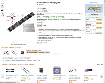

And +1 one on trying the SootEater if you have the access to use one.

That rotary system looks interesting. It looks like it would do a better job than just a brush. Although I ould think it would be messy to do it from the bottom up and have the insert door open while doing the cleaning. I was just going to keep the insert door closed and get up on the roof and do it top down. Any tricks for cutting down on the mess if you do it from the bottom up?

If you have easy access to the roof, top down is probably the way to go. I just remove my baffle and use the sooteater from the top and let the soot accumulate on the floor of the stove. Easy and clean.
I clean mine bottom up and its fairly simple to keep clean. Simply get a sheet of plastic and tape it over the door and either leave one corner open or to be more thorough poke a small hole in the plastic to run the brush shaft through. The only mess is the one on your hands when you are taking the shaft segments apart. Sure beats a reaching over my head on a two story roof.
I bought the SootEater and will report back after the first cleaning. Actually, I bought 2 of them because it was cheaper than buying 1 plus the additional rods I need for my 25' flue. At least I will have extra rods and a backup cleaning tool.

Sweet! If your results are as others here as mentioned over the years, you should do well.
Are you going to be cleaning from the top down or the bottom up?
If you go from the bottom up, just be careful when those weed-wacker-ish strings get up in the cap.
Keep us posted

As you guys recommended, I bought the Gardus Soot Eater:
http://gardusinc.com/sooteater.html
