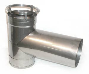

Most times a T like this is used
[Hearth.com] Creosote smell in basement!
The vertical part of the pipe is attached to the liner and lowered down the chimney when the liner goes in. There is a clamp on the "snout" part that the single wall pipe from your stove would attach to that you'd tighten once attached.
If your cleanout is far lower than your crock, then you could seal the cap at the bottom with furnace cement if it never could be reached, or you could put in a new cleanout. If the cleanout on the bottom is inaccessible, then sweeping the chimney would require you to cleanout through the "snout" by removing the stove pipe.

You can make the turn into the thimble, me and member Todd have both done it, but I wouldn't recommend it. It makes cleaning the flex liner harder to do and a lot messier. Use a tee.
