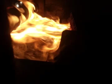

So i came ho.e from work with a renewed hope after talking with harmon and my dealer. Both pointed me to leaks somewhere and stated the starting issue and creosote will go hand in hand because of air fuel mixtures.... I inspected every inch of seal to see if i could tell where it wasnt sealing and i definitely thought it was the hopper door. Closest to the hinge i was able to see the line from where it sealed on the boiler. But on the red knob side you could see on the seal that it was not imprinted as much. So i actually went and got the fiber rope seal from TS and unthreaded about 4' of it. I threaded more threads through the existing hopper seal like threading a needle to make it a bit thicker. I also had some high temp 1/8" thick foam heat seal tape i use at work. I lined the hopper door and ever other door as a matter of fact with the sealing tape.... My results for starting were finally back to normal but in under 15min of running i literally watched stage 3 form in front of my eyes....[Hearth.com] Creosote[Hearth.com] Creosote
The second pic is 30min running and u can see dripping tar.... Yayaya!!! I get to scrape tar again!!!! WHAT AM I DOING WRONG. anyone want to trade a pb105 for three regular stoves?????

The flame in the second photo you posted Friday looks lazy to me, like it's not getting enough draft. The 5:06 photo from yesterday looks like the stove is starting to clean up the creosote, though. Do you agree?
