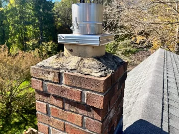

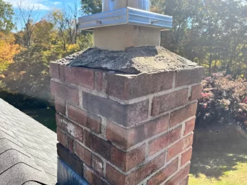

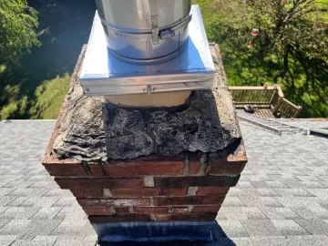

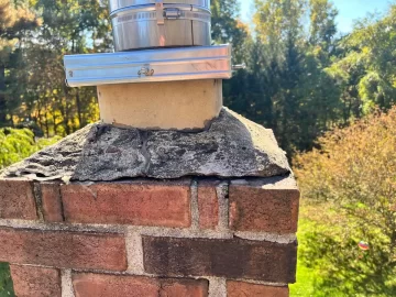

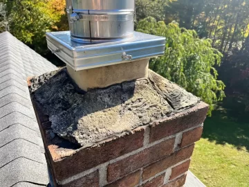

I have a couple questions about the crown on my chimney (which I had previously not been paying attention to).
First, does this need some TLC?
Second, if it does, is the custom stainless chimney chase cover from Rockford an acceptable solution?
I really don't want to hire anyone given the inflated cost of things right now, combined with the general incompetence of every chimney/stove "expert" I've talked to in my area. Although I feel like recrowning is probably something I could handle, I really don't have the time right now.
I'm wondering, if it does need repair, if I could break off the cracking mortar, order a custom cover from rockford, high temp silicone and some tapcons, and call it good for the next 5 years or so?

Yes, that looks like someone blew their nose on it and ran. A stainless top cap would work.

If you are just looking for a short term fix. Get you some mortar mix (S type) at a minimum. Go up and chisel/hammer off the “rotted” cap without cracking bricks or flue. Then recap it with the mortar. This will not last nearly as long as a properly poured concrete crown but will be the cheapest and easiest option till you can construct a proper crown. I just redid my chimney crown but created a form around it with 2x6’s and poured it with fiber reinforced concrete. Most masons in time past used mortar (just like yours) and it doesn’t hold up to freezing and thawing cycles on a flat surface.
If you decide to mortar patch the top or to pour a crown be sure to leave a gap around the flue tile for expansion and movement.

That definitely needs attention. It’s actually a pretty small crown. A mason would be best for that work, not necessarily a chimney/stove guy. It prob wouldn’t be that much at all. I had mine done about two years ago. I was shocked at how cheap it was. I even had to replace some bricks and had the chimney re-tucked.

Most masons here do a half assed job of it. No expansion joint no bond break no drip edge etc. Yes they are cheaper. But they crack quickly because there is no expansion joint
We do have good masons but they won't touch anything that small honestly

There is nothing wrong with stainless I just think a poured crown does a better job protecting the chimney and stabilizing the top.
If you do stainless take the old clay liner down flush and get a cover with a 6" top plate integrated. Much less chance of leaks

better late than never. got up there and redid this today. removed the cap, chipped off the old broken crown, installed stainless crown from Rockford chimney, four tapcon screws into the brick to hold it, hit everything with some caulk. Thanks for the help/input from all.
(yes, i know there's some creosote on that liner and cap, damp wood second half of this year, going to make improvements going into next year in wood storage and burning technique)
