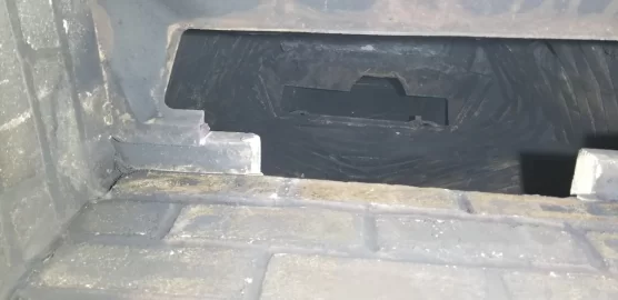

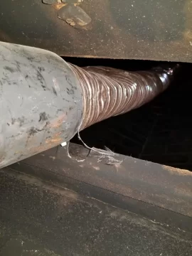

Hello all,
First post here. 4 years ago I had a Regency CI2600 installed by a local shop. Turns out it had to be replaced due to a warranty issue. Since the warranty is parts only, I decided to undertake this myself.
I found 3 issues with the installation.
1) The chimney liner was crushed to get it to pass the throat, way more than I think necessary. Is this a problem? Is there any way I can bend it back?
2) No liner insulation.
3) No block off plate.
I'm considering to get some rockwool for the bottom of the liner and fashion a block off plate as has been very nicely outlined on the forum, but what do you guys think about the first two?

That really is a horrible install. I personally would not use that liner.
Reactions: AlbergSteve
Even taking a sawzall to the damper (hey, you're never gonna use it again) would be better than that crimped up mess. I know some guys who DIYd installations nicer than that, I can't imagine a professional would be proud to have their name anywhere near what you've got.
Is the flue system by chance double wall that you wouldn't see the insulation from the outside?
Reactions: bholler
Thanks for the reply. In your opinion would this installation be considered acceptable by any professional? Do you think I should go back to the company and complain?
Not acceptable by my standards at all. The way they ovalized it was very bad. It is kinked all over the place. And it looks like they just used black pipe instead ofa proper adapter
Any tips on getting the old liner out? That thing is stuck pretty good...
Grab it with visegrips and pull if it is really tight it may unravel which is a pain and very sharp but it will come out.

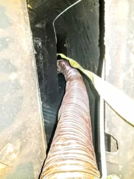

So I figured out WHY the crushed the liner.
It turns out that originally the house had these enormous arch fireplaces (like 5ft high).
When the house was renovated in the 80's, long before my stewardship, they made it a more traditional firebox, but they left the old smoke shelf/throat in place.....
It's about 4ft above the new throat and REALLY tight....
I would like to fix this, but I have no idea how to cut that out.[Hearth.com] Crushed Flue Liner Any help is much appreciated.

I would take out what ever is needed to get in there and open up that upper dsmper area. The chimney was also clearly not cleaned properly and there really is no way to without getting up to the old smoke shelf. This really was a very bad install in many ways
This is the point I'd get mad at it, and go ham with a sawzall on the lower damper and an angle grinder on that smoke shelf until I had a reasonable opening to drop a liner through.
Is that local shop still in business? If so show him the picture and see if he can make it right.
