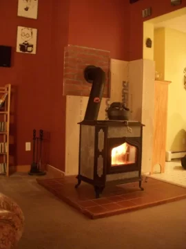

I've been thinking of building up a hearth sort of like https://www.hearth.com/talk/threads/14900/. I'd use cultured stone for a finished surface of the hearth and in back of the stove as well.
In our location, the thimble is flush to the wall - but I feel safer with some durrock up (+ 1" air in back of the stove and on the corner wall to the right of the stove, see pic).
Curious if anyone has found themselves in a similar situation and can offer advice / suggestions for an interesting design?
Many thanks!

First of all nice Wood Stove - good looking
Are you keeping the hearth on which your stove stands??
How about some Soapstone from Vermont. Quarry should not be to far away from you.
Cultured Stone is probably cheaper but just overused, everyone has it. (my personal opinion)
Even though there are nice examples on this forum pictured.
hey that's a great idea! I'll have to look into that. Thanks for the stove compliment too, its a Woodstock Fireview. Am considering replacing the tile hearth pad and building up a 6"+ platform for the stove to sit on.

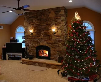

Here is what I did behind my stove with cultured stone. It is attached to durarock with 1 inch air space. It takes a while to do but if you take your time it will look nice.
  • [Hearth.com] Cultured Stone / Hearth design suggestions?
That looks great! Did you use some type of special spacer or thimble extension to get the stove pipe through the cultured stone and durrock?

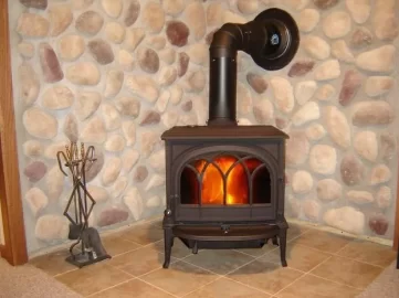

Quite a fire in that woodstock. You really pushed that rear clearance eh?

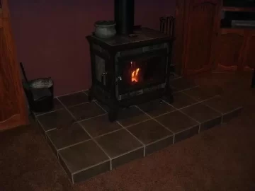

I'll be doing the same type of install as well. I have the woodstock fireview sitting in the crate just dying to get used. I plan on building the base with 2X6's and using cultured stone for the hearth and walls. I'll use at least 3/4 plywood on top of the 2X6's and then 1/2 durock. I believe this is what woodstock recommends. The hearth stones will go on top of this then.
not sure this will help with a wood stove design layout, but here's a pic of owens corning cultured stone.
