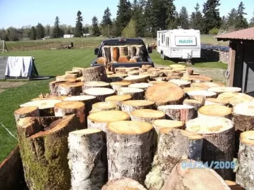

I cut the trees to 3 foot lengths and load them on end for a 6-pack type load. This way the logs can't fall out of the truck or trailer during transport. I cut to 18" for my 21" max length stove and really wouldn't want them any longer since that 3" allows some angle to the split when loading.
Here's a load of the 3 footers. They are cut exactly to 3 feet with a measuring stick and then I usually eyeball the 50/50 cut at the woodpile. My new Stihl saw has the dawgs on the saw body that helps to prevent the short log from kicking around on you.

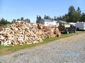

I just finished an 8' deep x30' long by 4 foot tall stack that would make you all proud. But I'm now more than three years ahead on wood supply so I need to sell what's not stacked.

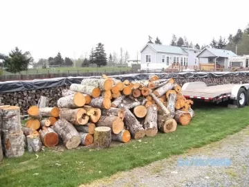

I even threw in a picture of it all split up plus my next score of LARGE fir and cedar wood. This wood collecting thing is an addiction.

Have you considered just cutting those 3' logs in half before unloading? That is, just swing one off the end and cut it in half right there? Not sure what your process is but it might save a little labor. You could even have another trailer there to throw them into as you are cutting. Maybe you can even convince your wife to help. lol
I'm a little afraid that the softwood might rot or get to dry after 4 years of waiting to be burned so I think I may sell or give some away.
I did not have the time or energy to cut those logs on the trailer. I left in the morning for my woodlot with an empty truck and trailer, arrived at the log pile and cut the logs to 3', loaded the truck and trailer, then drove home, then unloaded it that same day. When you laod a trailer you need to load them on the deck and then get up on the deck and relift them to their position. All logs get lifted and moved no less then four times. 4 times lifting 10,000# and I was pretty worn out. Those three foot logs get pretty heavy and when you are trying to get a decent pile you need to throw them. The big ones are pretty tough to throw. I want those three footers on the ground for maximum roll away resistance before cutting. I don't even cut them while they're in the pile so on the edge of the trailer would get really dangerous for me.
