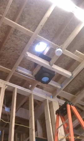

You can cut a ceiling joist and box in around it
I know you know better but you didnt state it clearly if you cut a joist you need to transfer that load to the adjacent joists and check to make sure those joists are large enough to take the extra load
Here's how I dealt with it in the barn. Use real joist hangers. This is structural.
  • [Hearth.com] Cutting Ceiling Hole
