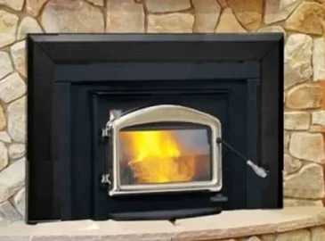

I like the shadow-box look for surround and would like the surround not to be much bigger than my opening. 38" x 28" would be about right.
Here is a crude photoshop of what I had in mine. Frame added to cut surround-size 38 x 28.

The problem I'm having with the dimensions request is that they are almost the size of the inner flashing. Can you post a full shot of the fireplace as it exists now and supply the current dimensions?
Current screen cover is 38 x 28. The box is 37x27.
The 1101 surround is 44 1/2" by 32".

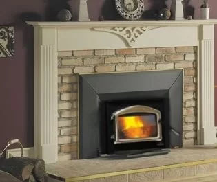

The 1101 with a surround like the one one the Osburn 1800 looks pretty nice.
  • [Hearth.com] Cutting Surround to opening size on insert
