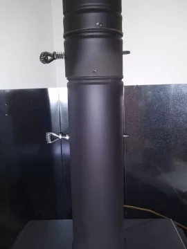

You can put put a damper through double wall stove pipe. Damper in this case means round plate with slide thru handle---not a complete assembly which has stove pipe included. I have one on my double wall stove pipe, plus I have a damper assembly.
I have a double wall pipe with damper assembly right on top of my legend 3. It certainly helps to keep the stove pipe temps in order when the intake air control cannot.
I remember struggling somewhat years ago fumbling to get a damper into a single wall pipe above a cook stove. I had to reach in with a wire or something to line up the damper rod.. No biggy, but it was so much simpler just plopping an assembly on top of the stove.
PS, my stove does not have a deflector on top, so...
I tried my damper assembly right on top of the stove. The handle was too close to the Airmate (deflector on top of stove). Hard to turn the handle. Worked better as I replied in your other post about double wall connections.
Are you using a longer damper rod to put a regular damper in your double wall pipe? If not there usually isn't enough spring to allow for the 1/2" air space
I didn’t know you needed a dedicated section for double wall. Why is that? Handle rod length?
I see it now.
No. I actually shortened the spring a bit. It was too tight at full length.
