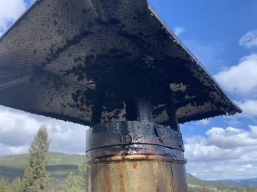

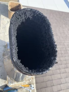

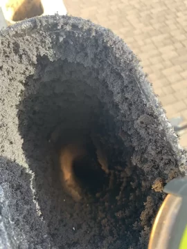

Hopped up on the roof to check my liner for piece of mind, was definitely more build up than I was hoping to see. About a 1/2" of flakey dry build up. I suppose I'm not running the stove hot enough, and some wood that wasn't dry enough. For reference the liner is 6" oval rigid insulated duraliner, about 16.5 feet.
I just ordered a SootEater, hopefully it will be here midweek. Im guessing I should not use my insert until this is cleaned out?
