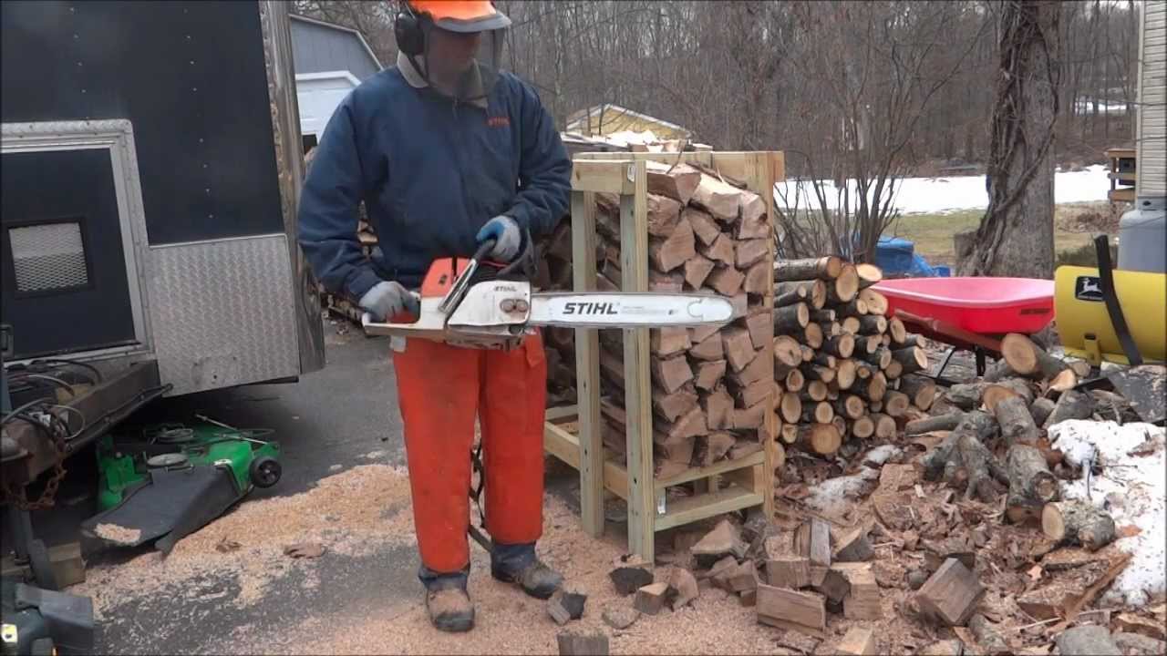

Build a rack, cut a bunch at once...I feel your pain, I had a VF200 the first year, and 15-20 cords of 22" wood...the 200 took 16" :(
After cutting 6" off every log that year, I decided I was going to find a 100. (I to had already started cutting at 20"...and you can kinda sorta fit an occasional 22" piece in the 100)
Here's a pic of what I'm talking about...just some scraps laying around (not my design or pic) works best to run a ratchet strap around the whole stack while you cut it...

I made one to shorten my original wood pile

That’s a good idea. My wood storage is a ways from the house. So once a week I load up my trailer with this weeks wood and drive it over to the house and park it outside the basement. So I’ll just have to make part of that routine cutting down that weeks wood before I throw it in the trailer.
