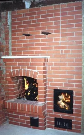

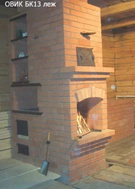

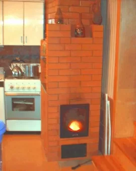

There are new ideas about masonry-heaters-as-boilers that are both beautiful and highly utilitarian. You can combine a masonry heater with a fireplace, and a heat exchanger to distribute heat to remote parts of the house. And, as per Kuznetsov's usual practice, you can install an electric heating element in the system for backup. So the thing could take care of itself when you are not there.
Here is a link to Alex Chernov's site in Quebec. He is sort of the N. American apostle of new 'Russian Fireplace' design.
www.stovemaster.com
Here is the source of the new ideas -- Igor Kuznetsov's site
www.stove.ru
See the Photos section. There must be hundreds of variations on the basic design.
http://www.stove.ru/index.php?lng=1&rs=22
Some samples attached --
