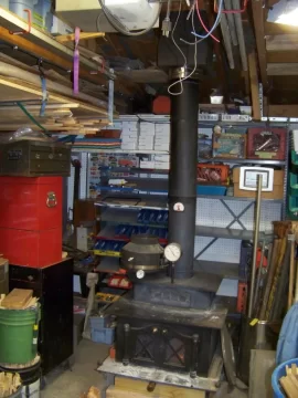

The flue is pretty much straight up and draws really well from what I can tell. As you can see from the photos, I've got limited space to install the stove, but it is a safe distance from the combustibles now that I've rearranged the shop to get wood elsewhere in the shop. I used single wall blackpipe up to the square box that attaches to the roof deck and then everything from there up is the triple wall stainless pipe right up to the chimney cap. This stove uses an 8" flue. Currently no damper except for the air control slides on each side of the stove. I burn a lot of free 2x4" end cuts from a pallet manufacturer here in Blackhawk Co. as well as a lot of free firewood I scrounge up during the warm months; mostly silver maple, ash, and oak/birch when I can find it free. Last year I swapped a guy two pickup truck loads of glued together oak panel rejects from a local cabinet maker for some rough cut walnut I had bought at an auction for like $10, so I have a wonderful mix of dry wood for this season. The "stash" is stored off to the east side of the shop with a shade tree storage bin made of a "lean-to" sort of roof consisting of the corrugated fiberglass roof material, oak pallets on the ground and open air drafting to aid in the drying process. The 4 section bin is roughly 4'x24' and about 6' tall. No clue as to how any cords of wood this has capacity for. The post winter and pre winter flue cleanings with the rod brushes from the top down have yielded only the slightest of black carbon deposits and nothing sticky that I can see. I installed a large industrial grade thermometer I picked up at a yard sale for a couple dollars and have one of the Magnetic cheapo gauges on the flue to compare temps. both gauges go up to about 800F.
