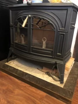

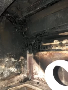

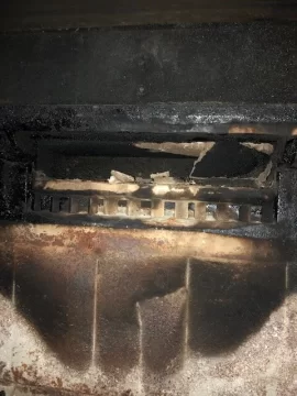

Bought this stove and it needs some work. It needs a new refractory box, and cat. New seals all around. My questions are, how big of a job is it to replace the refractory box? I have seen threads on this but was curious if ill run into other issues. This stove also seems to have a lot of black buildup in it. is this a problem?

Yes, it is likely salvageable. It just depends on what is discovered in the rebuild. The creosote buildup is indicative of how the stove was run. It might have been from poorly seasoned wood, but not a major issue.

Honestly I wouldn't put $700 into that stove. They just aren't all that good. There are many other choices that will be easier and cheaper to run and maintain.
To be clear the parts in question are not EPA parts. Vermont castings chose to design their stove that way to meet the required standards. Most other stoves from the time period met those standards without such delicate and expensive parts.
