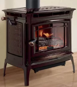

Do they have a Manchester on the floor?

They have one on the floor in that shop here, in enamel. That baby is gorgeous. _g

I don't want to highjack the thread but that Manchester looks great. I am happy with my 8020 so I may have to take a closer look at this stove. It's much bigger than the Heritage and still has a side loading door which keeps a lot of ash in the stove and not spilling out all over the place.

Seems the one here has an enamel heritage as well in brown mojolica if I remember correctly.
Very pretty. Just don’t know much about hearthstone. Looks as good as the Jotul to me so may have to take a look at them as well. Glad begreen mentioned them.

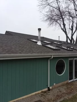

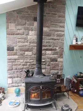

What is the total flue system height from stove top to chimney cap?
The chimmney from the top of the stove to the ceiling transition box is about 6.5 feet.
The transition box is about 6 inches
The outside chimmney is about 3 ft not including cap and I did not measure the cap.

Based on the image I'm going to guess there is more like 8' indoors and 3' outside. That is a short chimney for a modern stove and below spec for the Defiant FlexBurn. There are some stoves that may work ok with that short of a flue, but not many.

The stove drafts really well but the person I brought out here who sells vermont castings looked in the manual when he was here and told me my chimmney wasnt to apeca.
I was shocked since it worked with my last defiant and since I keep it clean it doesnt backpuff.
Once again my problem is the stove isnt radiating heat out into the room.
The person I had out there said he couldnt promise my anything but he said before I buy another stove I should at least bring this one to specs.
He sells stoves too.
I have had 2 other sweeps out here and they were befuddled why its 600 degrees and doesnt produce heat
Your thoughts are appreciated
