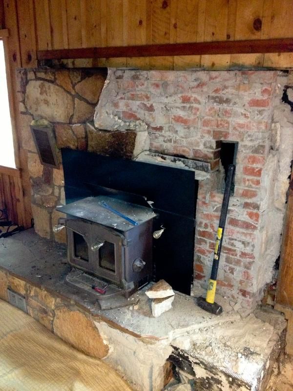

Howdy Folks. New in these parts and I'm getting started on a project. Removing deterioting fireplace façade and ledge and 1982 Fisher insert with the goal of adding woodstove (if enough space can be created or a new insert. Here is the start of demo:
[Hearth.com] Demo / Design options?

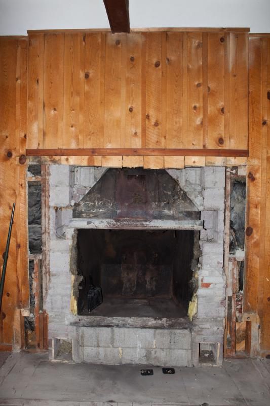

I have removed everything down to the following photos. If I'm going to install a stove I'd like to add an alcove if possible but I'm stymied by the iron box insert and wondering if I can remove it and if it will result in getting usable space.
A couple of concerns are the header that appears to be structural and the 4" ledge that would need to be removed to get down to the floor level after removing the box.
I'd like to remove the first course of cinder to reveal the interior of the chimney but it appears to be supporting this header:
You can see the chimney structure here revealed behind the first course:
... and here is the 4" poured ledge that would need to be removed to get down to the floor level.
____
All this is related to squeezing a stove into my small living room. If I go with an insert, should this massive iron box be removed?
Thanks
Paul
No, the iron box looks integral like a heatilator box. Alcove installs have strict rules for clearances and only a few that don't require 84" ceilings. A stove could be put on the floor or a raised hearth in front and connected to a liner or an insert could be installed. What are the dimensions of the fireplace?

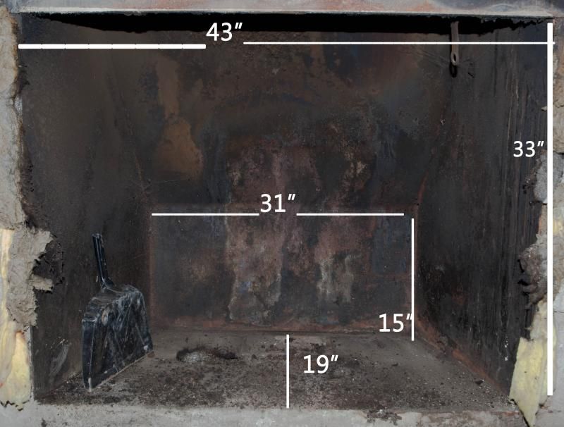

Thanks begreen. Looks like the box is staying. Here are the dimensions"
I am now looking at inserts.

Are you going to build out the front of the stove with a new veneer or facing? If so how thick? How deep is the stove at 17" and 19" above the fireplace floor?

At 17" deep the stove opening is 17" high. At 15 1/2 deep the box is 19" high.
