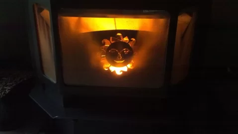

After burning one week around 5 bags of north americans i have black around edges. Brand new mt vernon hardwood setting. Not sure if that is typical thx.
  • [Hearth.com] dirty glass
Glass shouldn't be that dark, but there is no way of stopping the dirtiness.
The color should be a "Grey" shade for the most part. Depending on pellet brand, I may get a very light brown. But grey.for the most part..
I only burn mine on Low (90% of time) and I go weeks before cleaning. But when I do clean it, its Filthy :)

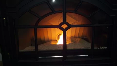

This was after a couple weeks of burnin last year.
