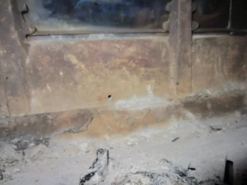

I have only had my PH for a few days, but i noticed that when the small air hole in the front center between the andirons is either partially or completely plugged or blocked by coals or wood that the bottom portion of the glass gets black and dirty. I started leaving some space around that hole and havnt had an issue the last 2 days. I use a carbon arrow shaft during reloads to blow any ash accumulation off of and from around the hole. The arrow shaft also is nice for blowing the ash accumulation off of the bottom of the glass where it likes to gather sometimes.

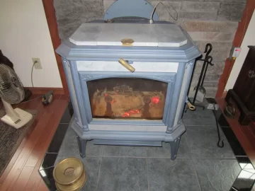

Not sure if it's the wood, the draft, or just slight differences in individual PH stoves. I'm burning 3 years old hickory and oak and my glass stays very clear all through the burn cycle. I am attaching a picture from this morning after a 14 hour burn on the lowest air setting possible. Glass is very clean with just a half inch area of darker stuff on the left side bottom. The stove is at 206* and the air is wide open and the cat disengaged. I will be reloading in about 30 minutes. I usually load the stove about 70% full (4 to 5 splits). Perhaps the PH's that get dirty glass are more air tight and capable of even longer burn times? [Hearth.com] Dirty PH glass with 3YR Wood

I will try this. I usually rake the coals and leave a hole all the way to the grate in the front center. However I've never actually seen this small air hole or tried cleaning it out. Where exactly is it located?

Haha, i just reloaded and its fully ablaze or i would take a picture. Its about the size of a pencil width, maybe a tad bigger, and is directly in the middle of the andirons, about an inch or two down. Its on the cast piece below the window. but before the ashpan grate starts.
If its covered in ash it can be impossible to spot. The only reason i knew to keep it clear was reading posts about the PH over the last few months.

I figured Super Bowl Sunday probably wasn't a good day to ask if anyone has a cold stove to take a picture inside. I'm going to let mine to cold tomorrow and see if I can figure out where it is.

The air hole in my PH is considerably smaller than the diameter of a normal wooden pencil. Maybe they have increased the size of the air hole?
If that is covered the coals don't burn down as well, for sure. But it has not seemed to have any effect in stopping wet wood from producing a black or brown film on a portion of the glass.
