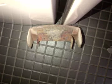

Has anyone noticed this with their Piazzetta's, my grate baffle plate is disintegrating (see attached picture)? Take notice how thin the little arm/hook is on the left side in the picture as compared to the right side. The shadow really shows how thin it has become. The stove is only 9 months old, I have burned about 3.5 tonnes. Would this be covered under warranty I wonder.... [Hearth.com] Disintegration of Piazzetta Monia grate baffle plate
Probably considered a normal wear item. Won't hurt to complain though.

I would be looking at getting another built by a local metal shop of a more fire resistant stainless. Looks like the one you have now is just cheap cold roll steel.
Dealer needs to know about the problem at the very least so the manufacturer knows they have a problem. But as Bioburner states, you might be better off having one built with better materials.
One, what pellets are 709GADE and gdphishman using? It'd be interesting to know if there's a specific pellet that is causing this kind of corrosion. I'm guessing salts in the pellets?
Two, just to be clear, that disintegrating flange doesn't really do a whole lot, it just helps seat the piece onto the firepot.
I've been burning mostly Trebio softwood pellets from Quebec, pretty much the only brand I could buy around here. I've burned a some hardwood pellets as well called Canawick, manufactured in New Brunswick.
Stainless isn't always the best answer. Fire resistant alloy is just as good, if not better in most instances but any material has to have some mass to it. They will all oxidize eventually, stainless included.
Okay, so no common pellet to blame for corrosion.
Would it be the fresh salty air? Not sure how close you folks are to the ocean. You're a captive audience on Newfoundland ...
It will be replaced under warranty, I talked to the distributor and they have seen it before in a couple instances.
