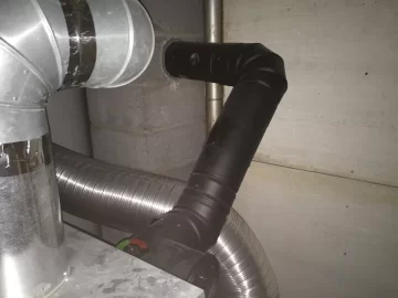

My daka exits horizontally, the Baro damper is the first piece and then the double wall. I looked at a single wall to double wall adapter piece and it was just a 3" piece that had he same exact connecting end as a normal double wall piece. No leaks, works wonderful.
  • [Hearth.com] Ditch the double wall connector pipe for Kuuma?
