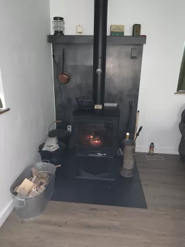

Hello everyone. We are thankfully going to replace our old Lowe’s wood stove with another Absolute steel hybrid but there is one issue I need to remedy before installing. Our current stove (see pic) has a serious issue with a lot of condensation dripping down the single wall interior pipe and severely rusting the old stove. Our home is ICF and absurdly well insulated and air tight. We have a very common issue of water actually pooling around the base of the stove during the heat of the summer. I want to prevent that issue but I don’t know what to do to achieve that goal. I’ve posted on this in the past but am finally able to afford to do everything.
Attached is a pic shortly after we installed the current stove 6 years ago. The chimney stack is 7’ of interior single wall and approx. the same double wall outside, all straight up. Would installing a damper along the ceiling that I close in the summer stop the condensation? Would double wall interior pipe help? I don’t want to install a significantly more expensive stove and have it rust out nor do I want this issue to continue. I don’t know what the root cause of this is as I’ve had multiple wood stoves over the years and never had such a significant condensation issue like this.

You say "......We have a very common issue of water actually pooling around the base of the stove during the heat of the summer...."
If the pipe shown in your picture above the stove is not insulated I would guess that's the problem. During the summer the exterior hot air fills the pipe and condenses inside the house since your house is air conditioned. To verify that, turn off the A/C during a very hot day and see if you still get pooling water around the stove
To my opinion the pipe above the stove should be double wall insulated all the way to the top. In addition, I would assume there is a damper just on top of the stove and this damper should be closed during the summer to prevent hot outside air entering the stove.
