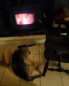

It's just a regular chair that didn't become a Stove Chair until I scooted it over by the stove. ;) To honor stove clearances, I should probably swap it out for a metal folding chair or something. :confused:
I guess I do have a picture on my phone, which was probably originally intended to be a picture of the brown dog.
Also pictured is my special custom hearth brush (aka $3 windshield scraper that got repurposed after the scraper broke).
[Hearth.com] DIY Hearth Pad for Wood Stove
