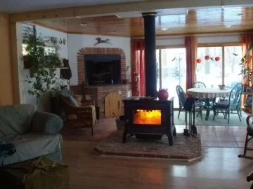

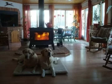

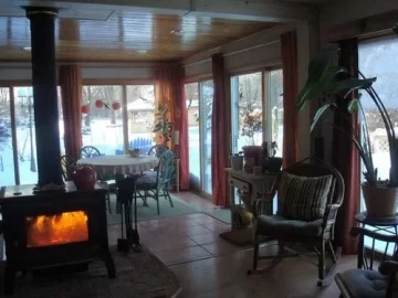

Just finished installing a Hearthstone Equinox. Used existing chase from gas fireplace. The chimney pipe was slid up into the chase with a little help from my neighbor. Took a little patience, but in having done the install myself, I am more aware of the inner workings of my system. I have sought much advice from this forum, I may add. Like yesterday, my wife called about some liquid creosote that had leaked from the adapter near the chimney support. I got home and dropped the pipe to see what it looked like, took pictures and felt comfortable about continuing to burn last night. The hearth I built was brick paver on top of fiberboard and micore. It looks rustic and my wife is happy. I will add that this install was tied into the removal of a wall connecting my family room and sunroom. It took me 10 days to finish it up. My stove supplier delivered the stove for $150.00 and charged and extra $25.00 to set and line up stove on hearth so stove pipe lined up. I am glad I did it myself, I never got an estimate for install.

jlow,
Dang! That looks nice, I love the open floor and the brick... Nice job!
