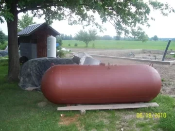

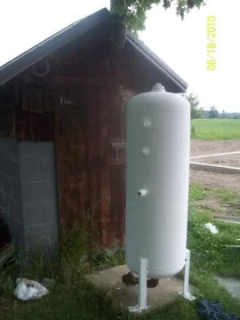

I have $765.00 in two 500 gal. propane tanks and a homemade expansion tank and that includes new primer, paint, and trailer rental to haul them but no plumbing. So no storage dosn't have to double the price of
your system.

I have $765.00 in two 500 gal. propane tanks and a homemade expansion tank and that includes new primer, paint, and trailer rental to haul them but no plumbing. So no storage dosn’t have to double the price of
your system.
765 for 1000 gal seems like a no-brainer. My HX was about 500. the Tank matierial another 500 so that is pressurized storage at the cost of un-pressurised. Nice!
Is this a Great deal or can tanks be regularly had in the 400 each range ?
your system.
Is this a Great deal or can tanks be regularly had in the 400 each range ?[/quote
When I was shoping around I found a lot of 500 gal tanks in the $350.00 range. The ones I got were $250.00 each but I have to take the rust and loose paint off and prime and paint. Then for an expanson tank I found what I think was a steam boiler condinsing tank on craigs list for $125.00 that also needed the finish re-done. Some people use 100 gal propane tanks for expanshion. got the exp. tank painted and 1 propane tank primed. It would easily be worth an extra $75.00 each to not have to strip and paint the big tanks. My expanshion tank is 80 gal and I'm not sure thats big enough so I may have to add a small tank to it.
