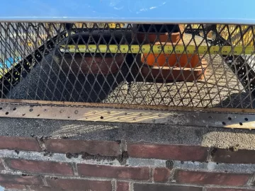

My house in the Boston area is a 1937 2-story Cape-style, ~1500 sqft. We have a central brick chimney (32" square on the outside) with 3 terracotta lined flues, each 6 3/4" square (size of the opening). The flues service 2 fireplaces (1st fl living room, and finished basement) and our gas boiler.

The only wrinkle in our installation plan is that the stove wants a 6" insulated SS liner, which will not fit in the existing lined flue. One installer has suggested breaking out all the terracotta tile to make space for a liner, and another has suggested running a smaller diameter liner (I think it would have to be pretty darn small to fit!). The stove manual says that using an existing lined flue is ok with a max size of 8" square, so I think that running stovepipe to the existing flue would be a third option -- but one of the installers was against this.

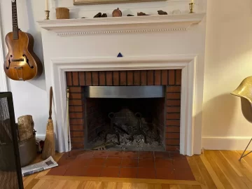

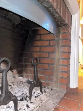

I've attached pictures of the flues exiting the top of the chimney, the firebox, and the hearth. While it's not exactly relevant to my question, I'll include firebox and hearth dimensions below. If you think I'm picking the wrong stove, or I should go with an insert, feel free to chime in.
Thanks 🙏
Firebox opening: 34 1/4" wide by 27 1/2" high
Firebox at back: 24" wide. 25" high at 17" of depth.
Hearth: 18" in front of firebox, 7" past sides of firebox
Distance to combustibles: 6" to trim at sides and top, 50" from floor to mantle
