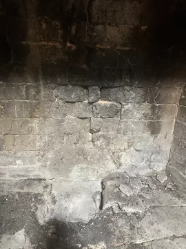

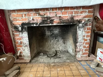

Good afternoon,
We have a 100 year-old home with the original fireplace. In the 1980s, a previous owner had put a gas insert into the fireplace which has been removed. We are now looking to put a wood stove insert where the gas insert was, but are struggling with finding one that will fit in the existing firebox. (We need a new face in it too, which will be taken care of)

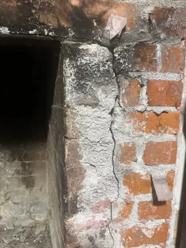

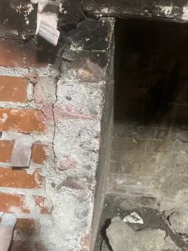

It appears the fire box at some past point came loose, and cracked on the sides (see the pictures below). Removing this old section of cracked mortar and brick will allow us to figure out how large of a box we can actually put into it. The plan is to remove the old firebox brick (back and sides) and install a wood insert fireplace.
What should I watch out for before I begin removing the section that is cracked on the left and right? Does the old firebox need to be replaced, or can it be just removed and a wood inseet be installed? There is no damper in place anymore, and a new liner will be installed. It has the cleanout at the back which will we are thinking will be left alone unless there is a reason it should be sealed up. I’m not sure what else I should be looking at. I appreciate your insights!

Note that there is a big difference between an insert and a zero-clearance fireplace. An insert goes into the existing masonry structure with an insulated, stainless steel liner installed in the chimney. One would not remove brick in that case. The opening looks pretty generous. If so, it could accomodate a large insert. An insert install could run anywhere from $4500-9000 depending on the model and liner length.
A zero-clearance (ZC) fireplace is sometimes mistakenly called an insert by marketing. If it were to go here, the entire fireplace, chimney and all, will need to be removed. Then a new enclosure (chase) would need to be built around the new ZC fireplace and chimney. A ZC install could run from $10-20k+.

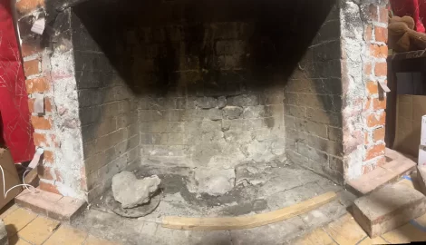

The pictures below indicate a closer look at firebox at the back, the cracks along the left and right side between the fire box and brick structure and a extended photo of the entire area.
If not removed, then shouldn’t they be repaired? Where can I find the requirements for the brick thickness around an insert? So far, my Google searches have shown nothing. is it buried in the NFPA?

It sounds like the insert will heat the stove room mostly and not the bedrooms. Take a look at the Drolet Escape 1500 insert, or its more upscale equivalent, the Osburn 1700. The more expensive Lopi Evergreen might also just fit.
